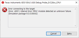

I am evaluating the F2837x with the controlCARD R1.1 and C2000Ware_3_03_00_00 examples.
I downloaded the LED blinky example and run.
But it seems to stuck the board.
When I check the suspend button while running, it stops at below line in sysctrl.c
// Wait for the SYSPLL lock counter
while((HWREGH(CLKCFG_BASE + SYSCTL_O_SYSPLLSTS) &
SYSCTL_SYSPLLSTS_LOCKS) == 0U)
