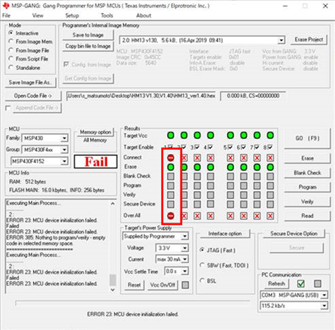

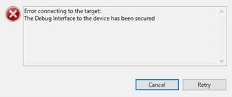

When my customer tries to access JTAG with a firmware update after mass production, the tool denies access.
The error when writing MSP-GANG and CCS is as follows.
MSP-GANG:
CCS:
1.Is the device secured?(security fuse is blown?)
2.If yes, is my understanding correct that the device cannot be unlocked forever? ??
3.Are there any other possible reasons why JTAG access is denied?
U-SK
  • 1. Maybe. I don't understand why in MSP-GANG GUI there is red for connection, but green for erase (how it can do erase if there is no connection?). Also this CCS window doesn't help to clarify situation.
    Master JTAG / SBW device can connect to target device, and than check if fuse is blown (device secured) or not. Don't understand why is this so complicated, that someone in TI office  for years can't implement reach error report in software, that user can without any doubts, read what is wrong with setup.
    2. In F4xx family there is real fuse that is blown by applying 6.5V from master device, and there is no reverse like with F5xx that have software value inside flash related to fuse state. If fuse is really blown than SBW / JTAG is locked forever. However, BSL should work.
    3. Yes, but easiest way is to do mass erase by BSL if it is (connection) enabled on PCB. With mass erased target device and reliable connection, master JTAG / SBW device should work OK with target if fuse is not blown.
    EDIT: Don't know if (for your F4xx)  there are factory calibration values inside info memory, so please check device datasheet to be sure. Because there is possibility that connecting to BSL with wrong BSL password (vector) all memory including info memory with calibrated data will be erased.

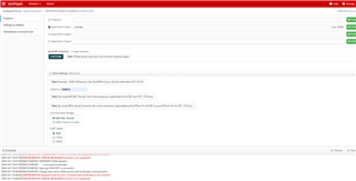

  • Hi Leo,
    Thank you for your reply.
    I have tried to do mass erase by uniflash.
    But following message is appeared.
    [2021/6/4 16:31:09] [INFO] MSP430: MSP430F4152(Bootloader)
    [2021/6/4 16:31:09] [INFO] MSP430: ..... Invoking the bootloader .....
    [2021/6/4 16:31:09] [INFO] MSP430: Opening COM PORT is successful!
    [2021/6/4 16:31:09] [INFO] MSP430: Change baud rate to 9600 baud to start bootloader communication
    [2021/6/4 16:31:11] [ERROR] MSP430: Response byte for sync command from bootloader is not received!
    [2021/6/4 16:31:11] [ERROR] MSP430: [ERROR_MESSAGE]File format is not supported!
    I selected the file to write first and pressed the Load Image button with the password blank.
    I have tried to select both ti-txt and hex format but the format error seems to occur.
    Is there possible cause?
    U-SK

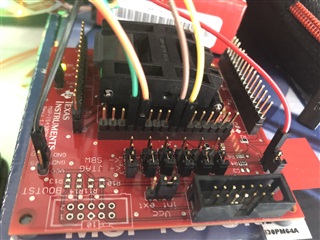

    This is indicating either a problem with the UART communication or the invocation command. Can you post a picture of the setup you are using here? Is this still using the MSP-BSL rocket?
    BR,
    Leo
  • Hi Leo,
    Yes, I'm using MSP-BSL Rocket.
    My understanding is following:
    1_TX           -----       52_P1.1
    2_TCK        -----       57_TCK
    3_RX          -----       53_P1.0
    4_RST        -----       58_RST
    5_GND       -----       J5_pin2
    6_Vcc         -----       JP2_pin1
    [Device Manager]
    [Uniflash]
    U-SK
