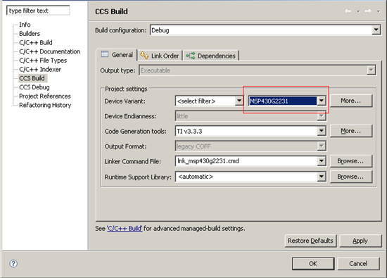

I have a quick question about code composer studio v 4.2
In IAR, if I want to change the target; I would right click on the project, then click on options, and change the target from  there.
I wanna know how I can change the target in CCS v 4.2.
During the set up of the environment, or workbench, one of the things a programmer would have to give the IDE would be the target name. Say I have given the target name, and after I have typed out my program, I want to change the target, without having to create another project, how do I do it?
  • In CCSv4, View->Target Configurations.  Then right click on the approriate .ccxml file (even make a new one if you need to) and Launch.  You will then have to Target->Connect Target
    This is the "manual" way of connecting to targets (sort of like CCS3.3 or IAR).

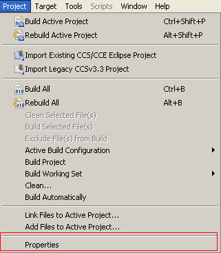

  • My recommendation would be to change the target MCU in Project Properties (under Code Composer Studio v4.2.1):
    Changing the target MCU in Project Properties will automatically load the corresponding Target configuration file (.ccxml) and the Linker Command File (.cmd), similar to IAR.
