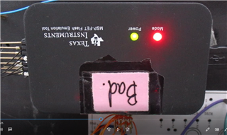

"I brought MSP-FET (SN:190100490) from mouser and now found defective as the RED LED is not blinking while good MSP-FET, the RED LED will blink. I can show u video on this matter. pls help to assit"
I tried to upload the video the customer is talking about but the uploading process does not proceed accordingly. I upload a screenshot(part of the video) instead. Kindly see below:
I hope you can help us with this. Thank you and keep safe.

Hi Pei Shi Lim,
Ok, first I'll assume you tried all the usual things, like connect/reconnect USB cable. Next, if you are up to the task, there is a way to 'cold boot' the MSP-FET as described in the MSP Debuggers User's Guide, section 5.6.5.3. Take a look and try this procedure.

Hi Pei Shi Lim,
Sorry for the delay and not sure why link is not working. The link is to the MSP Debugger User's guide ( link). Try again, but if link does not work for you, do a Google search for the name of the document and it will come up. See section 5.6.5.3. This will provide the steps to perform a 'cold boot' on the HW. If that doesn't work, then I will recommend Mouser replace the unit.
Hi Dennis, as check with engineer, the programmer is work now. thanks for your assist
