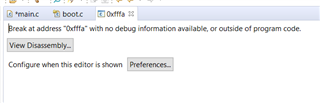

    4)Also I Have Been encountering the Problem sometimes in Debug Mode (Screen Shot below) But when I execute the Code without Debugger My Code Did not have any problem as I Was Able to get Data Continuosly from an I2C Sensor and Send it through UART it works without any break or error outside debug mode.
    Here The Code had Halted (*By me when i pressed pause button) at address 0xffffa, this is just one of the Address everytime i have this kind of problem address is different Every Time.

  • This Does not seem to find the root cause of the problem.
    I am getting this error in Debug Mode a lot of Time, break at Address 0x0XXX with no debug information available please tell me how to resolve this.
    Also the Boot.c file is also opening a lot of times (times refers to the number of times is power cycle the Debug window).Because of this again sometimes i am unable to start proper debugging of my Code please help me resolve the Problem of boot.c.
