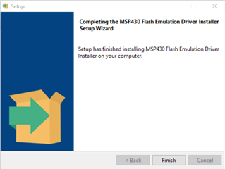

I am using "MSP430 USB-debug-interface MSP-FET430UIF" debugger to debug code with MSP430 microcontroller.
Recently I am facing error while debugging code(not being able to debug code).
I have observed that the device divers is showing" TUSB3410 Device", which earlier was "MSP-FET430UIF - CDC".
I tried another debugger which is still showing "MSP-FET430UIF - CDC" in device manager and was able to debug code properly.
I downloaded this drivers:
prod_no: ti_msp430driver_setup_1.0.1.1-windows.zip
ref_url:
Please let me know reason behind driver change and how to revert back to  "MSP-FET430UIF - CDC" or how to resolve the issue.
Thank You in advnace.

  • Hello Johnson,
    ti_msp430driver_setup_1.0.1.1-windows.rar
    I have attached drivers here with this reply.
    Thank you for your response.
    Thanks & Regards,
    Nilesh Patel.

  • Hi Johnson,
    I tried Uninstalling drivers and install it from device manager and still it was showing "TUSB3410 Device".
    I tried deleting the driver files "TUSB3410 Device"  by following its path in C drive but my PC won`t allow it and tells me that only installer can change/modify or delete it , hence I don`t know which installer it is talking about.
    Another important point which needs attention is when I connect both debugger at same time in same PC,
    1. One Debugger is showing "MSP-FET430UIF - CDC" and that debugger is working fine.
    2. Another debugger shows "TUSB3410 Device" which is not working.
     Note: I did not tried debugging the code with both debugger attached with PC at same time otherwise IDE will get confuse.
    So my point is if there is driver issue from PC then, Shouldn`t both debugger be showing "TUSB3410 Device"?? How come one is fetching right drivers and another one is not?
    Is there any chance of hardware issue in not working debugger?  and If it is then why it is showing this drivers as TUSB3410?
    Thanks & Regards,
    Nilesh Patel.
