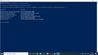

Ok,
I'm going to have you run a Windows PowerShell command to help locate if Windows is detecting the EVM430-FR6043.
Open a PowerShell command line as shown here.
Type the following, carefully, then hit return. If you get an error, double check your spelling.
gwmi Win32_USBControllerDevice | %{[wmi]($_.Dependent)} | sort description,DeviceID | ft description,DeviceID -auto
In the results, look for a HID device with the following VID/PID values (VID_2047&PID_0965). You should see 2 of these.
Hi Karthikeyan,
Did you have the EVM connected when you executed the PowerShell script?
I don't see any devices with VID_2047&PID_0965...

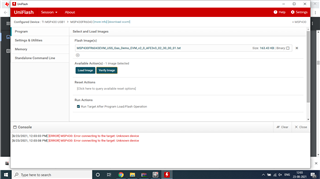

I am not able to flash the EVM430-FR6043 board. It says that there is no target device connected but the board is connected to the pc. What should I do now?

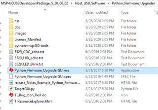

It that doesn't work, there is a python application that is included with the MSP430Ware (you may already have this installed in your computer under c:\ti\msp430ware_x.x.x.x , else use the hyperlink to download and install. Look for the directory usblib430\Host_USB_Software\python_firmware_upgrader. You should see an executable "Python_Firmware_UpgraderGUI.exe"
Before launching the GUI, there are two buttons on your EVM you need to push in a specific sequence to put the HID Bridge into BSL mode so the GUI can download new firmware.
Follow the button sequence, then launch the Python GUI. If you put the EVM into BSL mode, the GUI will detect it and is ready for download.
Next, download the attached file: TI_MSP_HIDBRIDGE__1_00_03_00__BANSHEE-USS-EVM.txt
Select it and the Python GUI will reload the HID Bridge firmware.

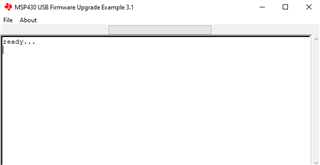

If, by chance, the EVM is not in BSL mode, the GUI will look like this:
Try the button sequence again, then in the GUI select file>rescan HID bus.
