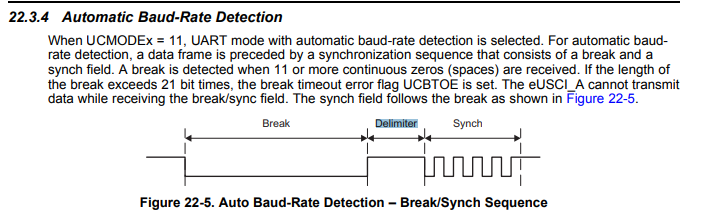

Dear team,
We configure the mode as UCMODEx = 11. In theory, the BREAK length of different lengths within a certain range can be identified in this mode in LIN communication, but can it meet the length of different Delimiters in LIN2.1 SPEC? If it can be configured, when using CANOE for communication test, it is found that the experiment cannot be passed.
