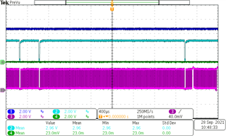

I am trying to control battery state control switches using GPIO pins. I used the same port but a different pin for setting PWM channels. However, my understanding is that these pins should not interfere with each other. However, even though my battery switch control output should be 1, it randomly goes to zero and turns back on. The pwm output also goes to low and high and sometimes this overlaps with the battery switch signal. Is there something wrong with the way I am configuring the pins? The code is supposed to sense the input voltage sensor value, trigger and ADC interrupt and enable or disable the battery switch. Thank you in advance.

    Here is the image of the signals, the light blue is the battery switch control signal which should have stayed on throughout and the pink is the gate signal for one of the power stages. The dark blue is the input voltage and since it is within the desired threshold, it should the battery FET should have remained on.
  • Hello Firehiwot,
    It looks like there is only one place in your code where the battery switch control is turned off:
    if (Vin_temp>=Vin_min){
    OffBattery();
    So this tells me some of your ADC readings satisfy this logic ( Vin_temp is >= Vin_min ) and turn off the battery.  If this is the case, you might want to double check your ADC values for potential random noise .
  • Hi Dennis,
    thank you for the response. I actually have two cases setting the battery switches off and yes, commenting out those lines of code removes the random changes in the battery voltage.
    When checking the ADC values in debug mode, I see that they are within expected range so not sure how I can debug this. Do you have any recommendations? Also just commenting out the SetDuty_Boost(D_boostH, D_boostL) line of code in second condition (which is the condition I am testing) ensures steady output of the battery switch control signal. Is there any reason why you think this could be happening ( this is the reason why I thought I may have problem with the way I configured the GPIO pins).
    Thank you,
  • I guess I could use the LED to detect if it's going to those lines of code, but still not sure why commenting out the duty cycle function affects the battery control signal. Here is the code for setting duty cycle for your reference.

  • Hi Firehiwot,
    Not sure why commenting out the duty cycle function would affect the battery control signals.
    Try to isolate the problem.  Reduce the code by removing the ADC portion.  Maybe setup a loop that calls your SetDuty_Boost() function and look to see if the P2.6 and P3.0 are affected in anyway.
