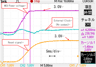

As shown in the figure below, when the reset voltage is 1.7V or less when the microcomputer is started, the external clock oscillates and the microcomputer operates.
It may not oscillate.
In this case, the reset input voltage when starting the MCU is 1.88V.

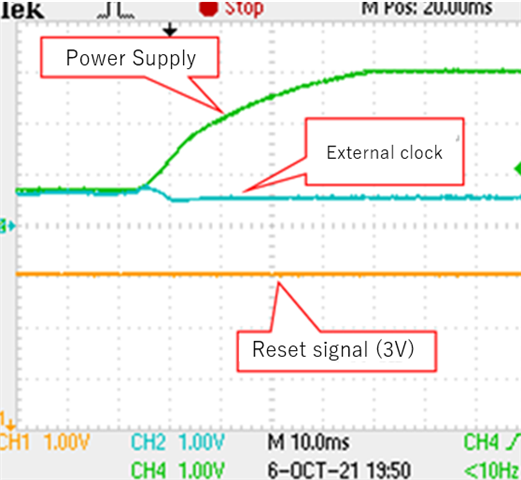

    Is it possible to control the timing of the power up for the reset controller you are using?
    Yes.
    When power is supplied to the MCU, the external clock may oscillate or the external clock may not oscillate.
    If it is started with 3V applied to the reset terminal, the probability of not operating is about 90%. Each waveform is shown below.
    [When oscillating]
    [When not oscillating]

    I will talk about the peak voltage of the reset signal when the MCU is started.
    Due to the specifications of the reset IC, the peak voltage of the reset signal fluctuates as shown in the following waveform.
    ・ 1.5V or less ・ ・ ・ Normal operation
    ・ 1.5v ~ 1.9v ・ ・ ・ Does not start normally and the external clock does not oscillate.
    I would like to know the reason why the MCU does not start when the reset signal is 1.5 to 1.8V.

  • Hi,Leo
    I attach the voltage waveform.
    It goes down for 9ms before returning the reset line to VCC.
    The figure below shows the time when the external clock does not oscillate.
    The above figure shows the case where the MCU is mounted on the product board.
    The figure below shows a single MCU and a 4MHz oscillator mounted on an experimental board.
    The figure below shows a 10kΩ resistor connected to the reset input terminal between VCC.
    Please tell me the reason why the external clock does not oscillate.

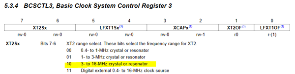

  • Hi Kenji,
    Can you confirm that you are using 4MHz crystal connected to XT2 pins?
    If you notice in one of your captures, XT2 starts up well before VCC has reached 3.0v.
    Since the XT2 driver is disabled at POR and software must enable it, this indicates that the CPU is operational and executing code at that point early in time.  Have you tried putting a 5 or 10ms software delay before enabling this bit allowing VCC to reach its full 3.0v?
    Also, there are several settings for crystal drive strength.  Can you confirm you are using '10' for XT2Sx?

    The actual circuit uses a reset IC and provides a reset time of 10ms when power is supplied.
    Also, the Xin and XT2 settings are set to 10.
