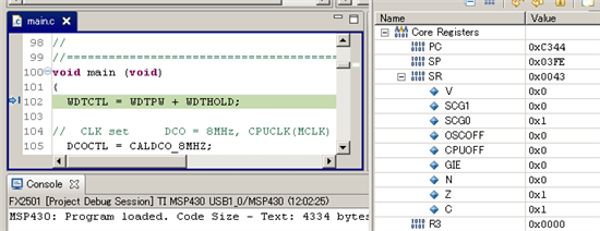

I found a curious thing today in debugging.
I make firmware with MSP430F2274DA, DA38 board. My IDE is CCS 4.21 Core Edition.
Some of my firmware set SCG0 bit of Status Register 1 at the beginning of debug session. Then it never changes.
That is, SR shows
SCG1 0
SCG0 1
OSCOFF 0
CPUOFF 0
This is not any low power mode. And the firmware seems to work fine.

    I want to know why SCG0 is set at the beginning of a debug session.
    With some firmware SR bits are (SCG1 -0, SCG0-0, OSCOFF-0, CPUOFF-0) after uploading of firmware. This is normal.
    But the firmware I am making now is different. After uploading SCG0 is already set.
  • Hmm, the firmware is not just uploaded - it already has started execution up to main().
    What does SCG0 'say' if you do not execute after upload?
    That's strange. Indeed, normally, SCG0 should be 0 after a reset.
    It might be possible that during the upload process, the FLL is deactivated, and when the applicaiton is started diretly after upload, SCG0 is still set (no real hard reset)
    It's also possible that the 'disable clocks' feature of the IDE (if there is one) affects the SCG0 bit.
    What happens if you start a debug session without previous firmware upload (and the MSP was powered down in between)

  • Thank you for your comments again.
    I created a new project with the same source codes. But it didn't change anything.
    I changed Project Property.
    • Software Breakpoint Disable
    • Erase Main Memory only
    • Create Flash Image
    I don't think this affects SCG0 bit. The setting is the same to other projects.
    In the debug session, even pressing Reset CPU button doesn't clear SCG0 bit. SCG0 sticks to 1.

  • I found a while loop affected SCG0 bit.
    while ( second < 5)
    _bis_SR_register(LPM3_bits + GIE);       // Enter LPM3, enable interrupts
    LED_Flash(1, 100); // LED1(Red) ON for 100ms
    • Description
      Variable 'second' is 'extern unsigned int'.
      Wake up by 1 second timer interrupt from LPM3. The interrupt routine increments 1 to 'second'.
    First I removed all codes of the main function other than watch-dog-timer disabling.
    And I left codes before and after the main function.
    Then SCG0 went 0 after uploading the firmware. It is normal. Then I found the while loop affected SCG0 bit.
    Then I left codes between {} of the while loop, that is,  removed a while construction there. Then SCG0 went 0.
    while ( second < 5)
    This seems to affect SCG0 bit. But I don't understand it.
