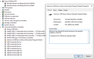

  • I don't get that far since my issue seems like a USB issue. Device manager shows
    so I can't get to the point you are because I can't even pass USB enumeration.

  • The ez-FET programmer on this board is an MSP430F5528 and is a down-stream device from the on-board USB bub device, TUSB2046, so if the HUB chip is bad, the F5528 won't enumerate.  Let me contact our customer support team and see if we can't get this resolved.
