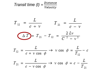

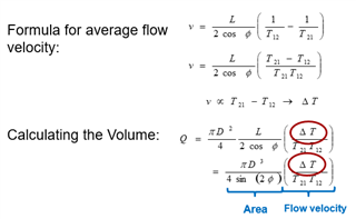

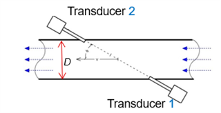

Hello team, I have a question about the theoretical background.
In the SLAA889.pdf uses the setup below
for analysis of ultrasonic TOF techniques.
Is there something similar for the setup below that you use in slaa949.pdf
Thanks in advance
