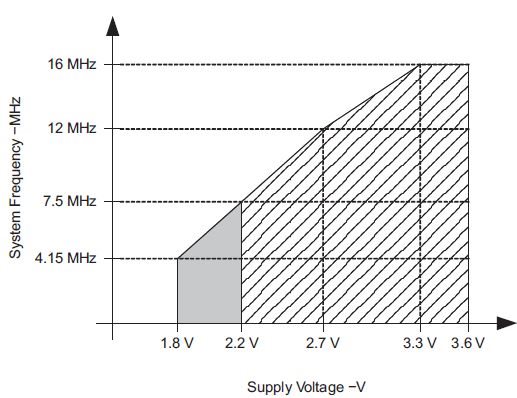

    I found a solution to this problem. I lowered the clock frequency from 16MHz to 12MHz, and then everything started to work properly! Is it possible that when using highest DCO frequency, the processor gets instable in the execution of run-time library? I don't have any clue.
    Further explanation would be appreciated.
    Thank you very much for you reply!
  • This kind of indicates you may have a supply voltage problem.  Note that you must be at a minimum of 3.3V to operate at 16MHz as shown in this graph taken from the 2274 spec sheet.
    If your setup is using a battery you may want to get a new one.  If it is powered by the debugging probe you may need to make sure you don't have some voltage drop due to some jumper setting or other cause on your target board.

  • Good catch, Jim.
    Usually, with VCC too low, the code will either still run okay, or run wild and fail to reach the checkpoint at all. Or crash completely.
    It's a rare case that it almost works and only the calculation results are wrong.
    But to give an additional answer to the DCO question: The DCO can indeed run the CPU with a larger frequency than allowed, even if programmed to do not.
    The reason is that the DCO ha sonly a few discrete frequency outputs. To get an average frequency, it is programmed to switch between two frequencies, a larger and a smaller one, every so often. The average frequency then might be okay, but during the process, it will still exceed the limit:
    e.g. if the DCO only has 15 and 17MHz output, it can be programmed to make one clock cycle with 17 and one with 15MHz, giving an average of 16MHz. However, every second clock cycle is too short to ensure proper operation. It may or may not work.
    Some time ago I calculated a maximum safe target frequency of ~14.3MHz when letting the FLL adjust the DCO output (for one specific MSP, based on the worst case datasheet informations)
