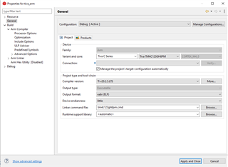

  • I do not know how much to blame on sysconfig anymore. It seems like sysconfig enabled projects lock the device variant, but when creating just a new empty project with the TM4C or MSP432 (no rtos, no sysconfig), the family is already locked.
    Attached screenshot: Properties of a new CCS project (simple main.c projoect) displaying device family already locked, and sysconfig not present.
    Edit: Maybe a better route would be one directory(Git repo), in there the common source dir, and the two different configurations as different CCS project - directories. And in the two CCS projects, refer to the common source dir as linked folder?
  • For the example in the screen shot did you try clicking in the box for the device.  When I create a new project for a tm4c123 with the wizard it looks like your capture but I can click in the box and change the device.
    2 projects with a linked folder with common source is a good idea.
