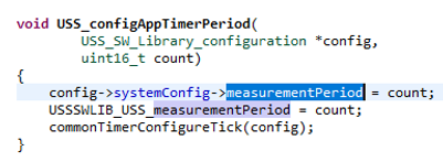

  • Hi Antony,
    There doesn't appear to be a command associated with this parameter.   Here is the only place it gets modified during run-time.
    It is used during the initialization of the GUI.
    I also looked through all of the design center parameters, located in the Design Center UG, section 11, but found now parameter.  So this appears to be a value that is set during initialization and not modified from the GUI.
    Now, with that said, since you are communicating with the FR6047 using UART to UART from another device, what protocol are you using.  How are you sending data back and forth now?  You could add a command that when the FR6047 receives it, call the function USS_configAppTimer.Period( ).
