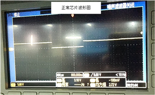

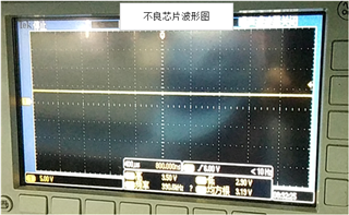

    The chip we use is not multiplexed,The test waveform is as follows
    Measure the waveform of pin 62 and GND. The normal chip waveform is shown in Figure 2, and the bad chip waveform is shown in Figure 3
  • Hi caixin,
    P62 is also a GPIO P5.3. Can it output high and low. I want to know that if this pin is shooted. If it can output a high/low signal. It seems that something wrong with the LCD module. You may looking for customer support center for further help.
  • Our LCD is normal. After replacing the good chip with the bad chip, the LCD can work normally.
  • Hi Caixin,
    I mean that some happened with the LCD peripheral of the device. Could it output low and high as a GPIO? I want to confirm that the internal circuit of the pin is OK. As you shown, abnormal device pin62 always output high? And could you list out all the abnormal pins like pin62?

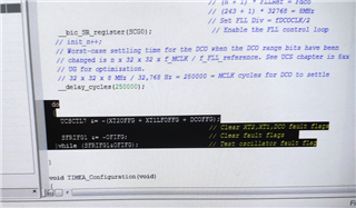

    At present, the program with abnormal chip is not running. Use the emulator to check the program operation online. It is found that the abnormal chip is stuck in the program shown in the figure below during initialization.
    The normal chip runs with the same program without any problems; Why does the same program cause this phenomenon on different chips???

  • Hi Caixin,
    As your description, the program stack at waiting for clock stable. There is some fault on clock.  You can test the XT2 to see whether the crystal oscillate normally.
  • Hi Allen
    We use the internal clock of the chip instead of the external clock, and the code is also written according to the braking file
    Could you tell me if the chip has quality problems according to these tests? If not, can you tell me what needs to be tested so that you can know what the problem is faster? In order to determine that there is a problem with the chip quality, I can feed back to the customer support center according to the results and ask them to return or exchange goods for us. Thank you

  • Hi Caixin,
    Go into debug mode.  Check the register UCSCTL6 to make sure you turn off the external crystal. You need to check the UCSCTL7 register to see which fault bit is set. If you use REFO for source and turn off the external crystal, the XT2 and XT1 fault bit should not be set. If the DCO fault bit can't be cleared, you run a clock example code at below link. It uses the internal REFO as source to configure the clock at 8MHz.
    https://dev.ti.com/tirex/explore/node?node=ANSXXA54TyfP9i3x6yqm-A__IOGqZri__LATEST&search=6736
    You can also do the corresponding test on the chip that can work normally to make a compare.
    If it still don't work on the abnormal device but work on the normal device at the same environment. You feed back to customer support center for help.
  • Hi Allen
    Good news, thank you for your advice. According to the chip modification method you provided, the product has been tested and can be used normally. Should your product be operated in this way since 13 years ago? Or did it start in the last two years? Because we never encountered such a similar problem when using this product two years ago.
