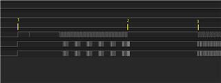

  • Hi Dennis,
    yes, regarding REFO it is like you said.
    My starup looks like this:
    1.  Starting point right after port initialization
    2. End of BSP_configureMCU()  - start CAPT_appStart()
    Time 1-2: 0.21s
    3. End of CAPT_appStart() - now the touch board is in the main while(1)
    Conversion count 150
    Conversion gain 100
    Time 2-3: 0.56s
    4. Point where I send 0x81 parameter Conversion count 420 - normal operation is stopped
    5. Here my host MCU start reading touch buttons
    6. End of Force calibration and start normal operation
    Time 4-5: 1.27s
    Time 5-6:  1.17s - here is my problem because the host device is not operational for this time (the user must wait for the first touch)
    Time 4-6: 2.47s - total time of Force Calibration. This time is the same if I send just 0x81 or 0x8E after 0x81.
    Form point 1. MSP430 is powered constantly. Measurements are done with P1OUT BIT1 so there is no mistake.

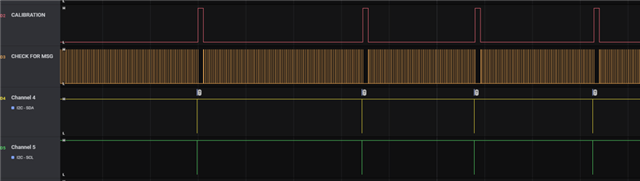

    Here is the picture of what is happening when the user presses the touch buttons too early (before point 6) - a few presses:
    Time 6-7: 1.27s
    8. Normal operation
    Time 6-8: 6.3s - depends on how long you will press the buttons but this is normal.
    I think time 6-7 is recalibration, but here is still the question of why this recalibration is two times shorter than Force calibration?

  • Hi Dennis,
    I found where is the problem.
    After the first start-up (power on) of MSP430, command 0x81 takes two times than normal.
    I added a short pulse on P1OUT BIT1 to catch calibration start:
    void CAPT_calibrateUI(tCaptivateApplication *pApp)
        uint8_t ui8SensorID;
        // Loop through all of the sensors in the application pointed to by
        // pApp.  For each sensor, call the appropriate calibration routine via
        // the calibration macro.
        if(P1OUT & BIT1)
            P1OUT &= ~BIT1;
            P1OUT |= BIT1;
        else
            P1OUT |= BIT1;
            P1OUT &= ~BIT1;
        for (ui8SensorID=0; ui8SensorID<pApp->ui8NrOfSensors; ui8SensorID++)
            CAPT_MANAGER_CALIBRATE_SENSOR(pApp->pSensorList[ui8SensorID]);
    Here is the picture when a normal power-up happened:
    1. Power up
    2. Here I send 0x81
    3. Point where calibration actually starts (short pulse on P1OUT)
    Time 2-3: 1.25s
    Time 3-4: 1.25s
    Channels below are SCL and SDA lines of the host MCU.
    Point 2 more precisely:

  • Hi Igor,
    I using FR2633 EVM and FR2433 Launchpad as the host.  I want to point out that I have the FR2633 configured to be one sensor with 4 elements where each element is in it's own measurement cycle.  This would be the same as the FR2512, 4 elements, 4 measurement cycles.  Because of this, when a calibration is performed, it is done one cycle at a time, so again for the FR2512 it would take 4 calibration cycles. I'm using 150 for the conversion count with f/4 conversion clock (4MHz).  The effective conversion rate is 2MHz because one clock cycle for charge, the second clock cycle for transfer.
    I can get the host to send 0x8E.  In this picture ch2 trace is the calibration being performed (112ms for the 4 cycles).  The ch3 trace is the slave checking for inbound packet in the app_handler where I toggle an IO pin.   Ch 4,5 are I2C.  As you can see there is only calibration per request.  The first calibration on the left is my first request for calibration after device reset.
    Here a zoom in showing the relationship between when the 0x8E command is received, then checked for inbound packet, and calibrated.  Notice the command is asynchronous to when the slave is checking for inbound packets, but on the next check it processes the command and performs the calibration.  I only see one calibration per command from the host.
    And here is the I2C message.
    I'm still working on getting the quicker calibration routine for you.
    Do you by chance have an oscilloscope or does your logic analyzer have analog channels?  I ask because I may have you probe each of the four Captivate channels and measure the actual time the electrodes are performing the charge/transfers.
