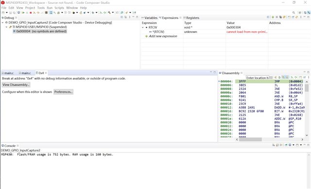

I am currently developing a door magnetic switch using msp430fr2433.(Environment: CCS10.4.0)
Firstly, I tried to use driverlib to speed up my development. As two buttons on launchpad are linked to P2.3 and P2.7, the example code run well last week and I thought it was simple.
However, there is another button linked to P1.1 on my own hardware. I tried to modify code like this.

I downloaded this code to my launchpad. Two new buttons: P2.2 and P1.5, I used DuPont cable to short them to GND instead of pressing buttons.
Then some problem occured. The code doesn't run well and in debug view, the code stopped at JMP __TI_ISR_TRAP in isr_tram.asm
I just press start and suspend in the debug view and didn't press any button on my hardware.
I tried again to the original example and it seems to the same problem.
I also tried the example without driverlib: msp430fr243x_P1_03.c but failed just the same.
I'm confused why this happened and I'm sure there's nothing happened to my computer this weekend.

  • By viewing other posts, I tried to use DuPont cable shortcut 5v and GND to let the board fully discharge. (launchpad unconnected with the computer)
    Every time debugging after discharge the bord, it could run step by step to: __bis_SR_register(LPM3_bits + GIE);
    When I press the three buttons connected to PORT 2, it still works correctly.
    Just when I try to shortcut Gnd to P1.5(just like pressing a button connect to P1.5) the code run away to: JMP __TI_ISR_TRAP.
    The delay_cycles in code ISR is used for key debounce, cause there is no debounce capacitor on launchpad

    Some old problem occured. This situation happened last week, but it could not be repeated yesterday, so it was not sent out.
    The code can be debugged step by step till:_ _bis_SR_register(LPM3_bits + GIE);
    But when I press the button, it just happens.
  • > void P1_ISR (void)
    This should be:
    > __interrupt void P1_ISR (void)
    Similarly for P2_ISR()
    Unsolicited: To enable a pin interrupt you should (1) Set IES (2) Clear IFG (3) Set IE. You can do (1) before clearing LOCKLPM5, but you have to do (2)/(3) after. The symptom would be spurious interrupts rather than a crash.
  • It works right now.
    Thanks for the explanation.
