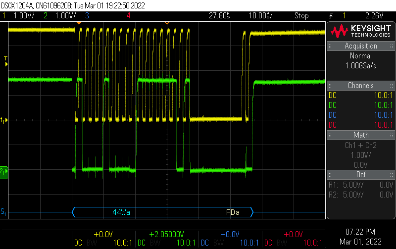

    From the scope traces it appears that the address and your data (0xfd) are sent. Then it waits (delay_cycles) till you request a stop condition. A stop halts the transaction and you have to start over again for more data. I suggest you look at the code examples provided by TI.

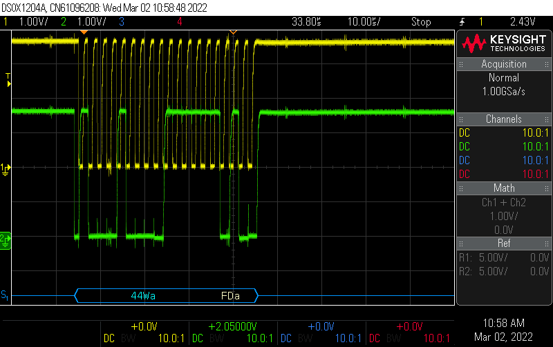

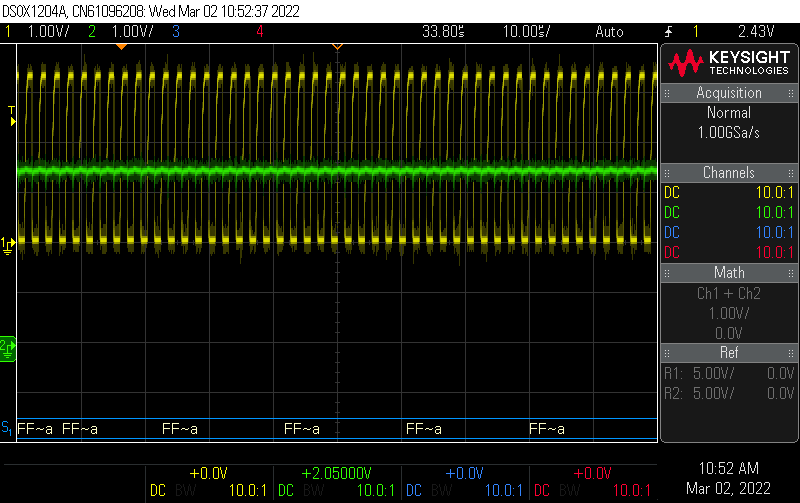

    This is my updated code, my issue is after transmitting the stop command, I2c communication keeps on transmitting.

    only by sending the extra data to the TX buffer, I am able to get the desired output
  • Hi
    What do you do after I2C transmit? After you send STOP signal this I2C will stop, it should not need another byte to stop function.
