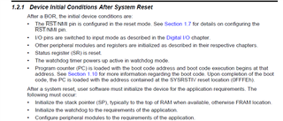

SLASE54D – MARCH 2016 – REVISED JANUARY 20) has little to no information about the reset operation.  It simply states the reset line should be held low for 2uSec.  It say's nothing about what voltage levels cause what action.

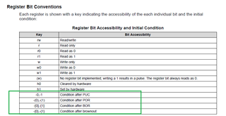

The programming document (SLAU367P – October 2012 – Revised April 2020) say's a little more, but nothing about the electricakl operation of the reset signal.  The SFRRPCR register remains untouched by the running code.  (Set for RST, with a pull-up enabled.)

What is going on inside the MSP430's RST line?

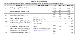

Where can I find the electrical min/max for the reset line?
Where can I find the electrical characteristics of the RST line?  (RST is starts at ?VCC, RST terminates at ?VCC,..)
