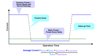

On page 28 of the MSP430F6779 datasheet. It shows the power consumption difference of executing from Flash Vs RAM. See table 5.4 below. RAM Icc  is about 1/2 of Flasf Icc
If we load some code that is used often from Flash into ram on power up, and then execute this section of code from RAM,  Should we expect a reduction in power consumption.?
Theoretically if we executer  code 100 % from Ram we would expect power consumption to be ½ that of Flash.
Correct?
Thank you

  • Hi Joe,
    Actually I don't think so. The current will drop so much.
    1. I think your device will enter LPM mode. If the time is so long. You can not find it will do much help to your power consumption. You can calculate the help use the picture shown as bellow.
    2. MSP430F6779 have a very small RAM, you can't put a large code into the RAM. Normally, people putting code into RAM is for high speed code running.
    3. If you meet the power consumption problem, I would advise you full use the low power mode and change your code strategy to make the active time smaller.
    Eason

    Following up to point 1 in your response, are you saying that the code in RAM will execute quickly and the device would then enter Static Power/Power-Down mode so any current savings would be minimal over time?
    What if the device was always in Active Mode and running? If Joe was able to execute entirely from RAM would his power consumption assertion be correct?
    Jacob

    Thanks for the follow up. For item (1), thanks for the confirmation. Understood now that, if you execute the code more quickly via RAM, it would allow you to quickly get to a static power state.
    However, I believe that then ties into the (2) power consumption point.
    In the application being considered here, I don't believe that the "Static Power" mode will ever be used. For the intended application and the "power consumption assertion" comment, we're looking at the device always operating in the "Active Mode".
    If we always operate in the circled regions below (no power down/low power mode), would the assertion that
    then be correct?
  • I assume it will be a little higher than 1/2. You also need to consider the peripheral power consumption.
