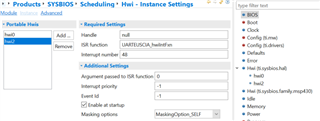

I am trying to set a hardware interrupt on Port 5 and toggle LED connected at P1.1, Below code is the ISR. I have found many thread like this on this isse. However, I could not resolve it. The error is related to "#pragma vector=PORT5_VECTOR" line. The msp430fr5994.h defines PORT5 like this :
#define PORT5_VECTOR           ".int27"                      /* 0xFFC6 */
which I think creating an issue here.
The compilation error is : error #10056: symbol "__TI_int27" redefined: first defined in "./main.obj"; redefined in "C:\Users\kamle\OneDrive\Desktop\Work\RWL\TI_RTOS\Blinky\src\sysbios\sysbios.ae430X<BIOS.obj>"
I have modified the existing TI RTOS example for blinking LED on the 430FR5994 Launch Pad. Most of the suggestions are saying to check for redefinition in any of the header files. But I can't find one. I am using the headers included within the example itself. Please help.
