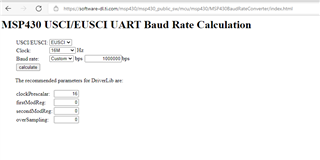

I need to set a 1Mbps uart baud rate with EUSCI_A0 or EUSCI_A1. Currently, I am using internal clocks on the EVM, the actual PCB will have external crystals. Is there a baud rate calculator for the FR series? It looks like I may need to set up over sampling in combination with Tables 30-4 and 30-5 from SLAU367P.

    The link that Keith shared is the correct calculator for the DriverLib parameters.
    You can also check out the UART Lab in MSP Academy to see an example and explanation of how Baud Rate is set for the EUSCI_A0 Module at the register level. In the document you mentioned, Section 30.3.10 of the MSP430FR59xx Family User's Guide (SLAU367) explains the step-by-step process as well.

    Prya, here is another BR calculator...
    4137.MSP430UartCalc.zip
  • For SMCLK = 16MHz, the BR calculator shows the above values. What is the error rate for this setup?
  • In the family guide linked above there is the following chart, as well as how to calculate the error:

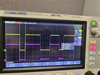

    I am trying the driverlib uart example, modified for external crystals (high and low) and UART A1. I put in the uart baud rate parameters for EUSCI. I know the external clock is working, the u32ClockFrequencyCheck reads 16000000.
    The UART is not working as it is currently setup. Any pointers appreciated. Thanks
  • Hi Priya,
    Your actual UART configuration seems okay to me. Just to confirm, when you say it is not working do you mean you are never seeing any UART data on pins 2.5 and 2.6 when they are tied together?
    Is the code hanging anywhere when you run a debug session?

  • Hi Priya,
    Here is a stripped down version of the Driverlib code that is currently working for me on the MSP-EXP430FR5994 at 1Mhz Baud Rate, using eUSCI_A1. Here I am using the internal DCO at 16Mhz. As far as I can tell the UART portions of these two code versions are identical, all I've done here is restore the clocking configuration to the original example code, and modified it for 16MHz BRCLK.

  •  I just realized a physical connection is needed for loopback. UART activity is as expected. I believe DCO CLK is set to 16MHz.
    CSCTL1 = DCOFSEL_4 | DCORSEL;                           // Set DCO to 16MHz
    I am seeing the baud rate is slightly off. With DCO clock, I get 980.4kHz bit clock. With external clock, I get 925.9 kHz. Its not exactly 1MHz. Why is this?
  • Hi Priya,
    Since the BRCLK is just being sourced from DCO or the external crystal, any error in higher frequency clock will show up in BRCLK.
    The DCO is just a variable RC Oscillator, and it is very likely that it is not operating exactly at 16MHz. The DCO is also being periodically corrected by the internal FLL. The way this is handled, it will on average generate a frequency around 16MHz, but at any instant it may be higher or lower than the target frequency. Variations in voltage and temperature can also cause changes in operating frequency. Table 8.12.3.3 of the device datasheet can give you an idea of the frequency error you can expected under different settings.
    The error with the external oscillator does seem on the high side though. What oscillator are you using? It may have some specified frequency error, and that error can be made worse by layout or schematic issues.
    Brandon Fisher
  • The allowed 16 MHz crystals have +/-50ppm tolerance. On the LP, this crystal was hand soldered which ay account for some errors. I played around with different drives and went back to my original one. A randomly checked bit is measuring at 1 MHz which is good enough for now. If there are problems later on, there maybe other ways to quantify accuracy. Thanks
