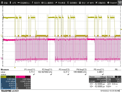

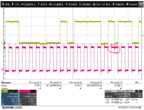

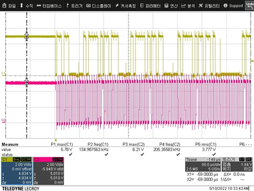

MSP430 operates in 3Pin-SPI Slave Mode (A1 Channel) and I2C Master Mode (B0 Channel) with no external crystals
I want to keep sending I2C Data to I2C_Slave(IS31FL3xxxx) while stacking SPI_Master's SPI Data into an array buffer called receiveData.
Currently, it has been confirmed that the operation is normal if only the SPI function and the I2C function are operated separately.
However, when the source code is combined to use both functions, I2C Communication normally, but SPI Communication fail.
When I check with the debugger, several SPI data sent by the SPI_Master are continuously lost.
By the way, if I erase the CS_initFLLSettle() function in the 135th line of the source code, SPI communication works normally again this time, and I2C communication fail.
I would appreciate it if you could give me advice on how to fix the source code

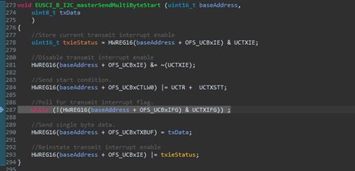

void I2C_WRITE_DRIVER(uint8_t address, uint8_t Reg, uint8_t Data)
    TXByteCtr = 1;                          // Load TX byte counter
    i2cdata_tx[0] = Reg; // Select Register
    i2cdata_tx[1] = Data; // Command data
    EUSCI_B_I2C_setSlaveAddress(EUSCI_B0_BASE, address/2);
    while (EUSCI_B_I2C_SENDING_STOP == EUSCI_B_I2C_masterIsStopSent(EUSCI_B0_BASE));
    EUSCI_B_I2C_masterSendMultiByteStart(EUSCI_B0_BASE, i2cdata_tx[0]);

  • Hi Kyung Won Seo,
    Do SPI and I2C transactions overlap? If so you may be dropping data because you are busy servicing an ISR. I notice that you have statements with while(condition) inside your ISR. This will increase the amount of time you are spending in the ISR and increase the chance that you may drop data.
    To get an idea of when the ISR is running, set a bit HIGH at the beginning of the ISR and then set it LOW right before the ISR returns. Assuming you have access to a logic analyzer or oscope, you can tell if there are overlaps. For example if you are servicing an I2C interrupt and you recieve 2 SPI transactions during that time it is likely that you will drop SPI data.
    It is always good practice to spend as little time as possible in the ISR.
    Evan
  • Hi, Evan.
    Thank you for your reply.
    I modified the code so that SPI and I2C communication ISR do not overlap each other.

    It still didn't work normally, so I took a waveform with an oscilloscope.
    It is measured that the SCL waveform periodically performs abnormal operation.
    Its enlargement is as follows.
    So I added code '__delay_cycles(1000);' after line 148th of the source code.
    Then, the SCL waveform changed like this.
    I downloaded the source code to my device and operated it, it seemed to work normally for some time.
    But after a while, an error occurred in my device.
    It's the waveform at that time.
    If I check with the debugger, the source code stuck in this location.
    Please help me solve this problem.
    thank you.
  • If the device is stuck on that line it is waiting for the UCTXIFG to be cleared. The fact that your I2C bus is pulled low means that someone is holding it low (idle state of I2c bus is high). Is the MSP or the secondary I2C device holding the bus low?
