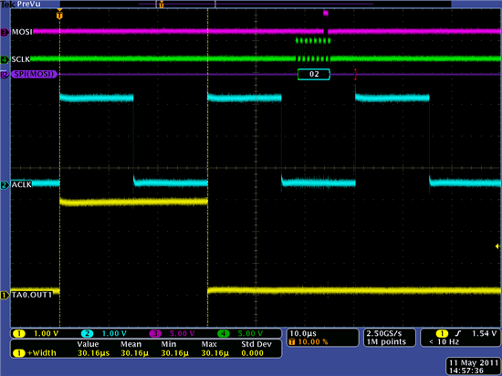

  • Hi JMG,
    I was intrigued by your idea that the second action might always occur as the counter counts from CCR0.  So I reviewed my notes from before and even did a couple of extra tests.  Alas, no, the second action occurs counting to CCR0 in continuous and up-down modes, and it occurs counting from CCR0 to zero in up mode.
    Since two pair of eyes are better than one, please take a look at this:

    Which generated the following scope image:
    When I switched to MC__UP instead of continuous, the ISR still captured a TA0R value of 2, but the falling edge on TA0.OUT1 came afterwards; one cycle delayed:
    So the final conclusion remains the same, and the documentation is still mostly right.  The examples and diagrams that are specific to each counting mode are accurate.  The summary statements later are too general and don't mention the peculiarity of double-action outputs in "up" mode.
    Jeff
    That's strange. This difference makes no sense except if intentionally included (or accidentally, which then indicates a bug or at least a glitch in the design, and may disappear in future MSPs when the timer circut is refined)

    p.s: you have a nice scope. What is it?
  • Yes, TimerB has the same results.  Don't forget that these results match the documentation specific to up mode:
    and for Timer B:
    I would say TI definitely provides this special behavior on purpose.  For some people using PWM, it makes considering the CCRn values simpler knowing that the second action occurs at zero.
    And I agree about the lowly TimerA2.  Effectively it has only one PWM channel.  To get two, you'd have to use continuous mode and be very very careful with high and low duty cycles.  Not really practical.
    Jeff
    My scope is a Tek.  I really like it.  http://www.tek.com/products/oscilloscopes/mso4000/  (and no, I don't work for Tek).
