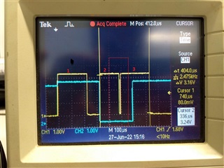

    I still need to check the BSL invoke signal here. Could you zoom in and take a look at this pulses?
    Based on the datasheet chapter 8.44. The Tsbw,Low should lower than 15us. If your pulses last longer than 15us, then the invoke process might be failed.

    I took photo of the signals and here I am again.
    What I have done?
    I tried to record the MSP430F5418A using the hardware rocket Olimex MSP430- BS as before.
    My script:
    MODE msp430f543x 9600 UART COM5
    VERBOSE
    TX_BUFFER_SIZE
    I have made 3 photos so you have better understanding on what I am trying to show.
    In the image bellow:
    Blue signal = = /RST
    Yellow signal = Test
    This first photo show the overall entry sequence. Which I believe to be wrong, but tell otherwise. The yellow signal, test, has 3 steps where should have only 2.
    A smooth zoom in and making the cursor goes on the signal.
    Now a huge zoom in on the red box I draw in the image before.
    As you said, the signal is shorter than 15us, but there is a extra step. And now, I do not know if this extra step is making the entry sequence wrong.
    The extra step between 1 and 2 should not affect the BSL invoke process. Could you get a capture of the RX pin after you send a BSL password on the TX pin? You should get an ACK signal on the RX pin.
