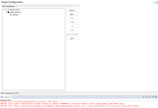

I am getting the "Load program error" while working with the mentioned part number launchpad. I tried the following link also for the rectification but unfortunately it did not workout for me.
https://software-dl.ti.com/ccs/esd/documents/troubleshooting-data_verification_errors.html
I am attaching the image for the reference.
Would appreciate your quick support on this.

Your generated linker command files should work if all you did was change the project target configuration in ccs. I just tested loading this empty project onto the MSP430FR2355 launchpad using CCSv11.2 and MSP430Ware 3.80.05.04.
What version of MSP430Ware and CCS are you using? Have you made any modifications to the empty project yet?
Address 8000h on the MSP430FR2533 is FRAM and should be writable unless write protection is being set on your device.

I am using CCS 11.1 version and 3.80.14.01 MSP430Ware and to answer your second question, I tried to configure the clock for 24 MHz, after that i was getting the program load error for every kind of program even the empty project.
However I referred the following link related to same problem available on this platform itself.
I am attaching the solution image that worked for me.
