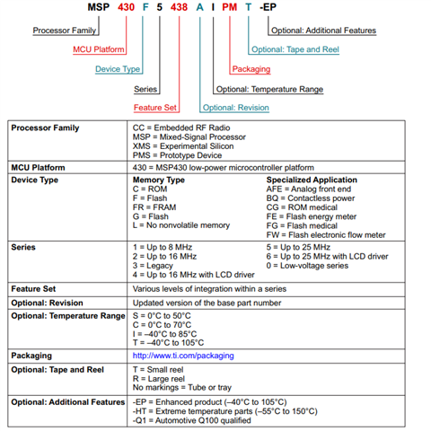

    As a side note, the only difference between the IPZ and IPZR devices has to do with packaging. I've attached a screenshot from the datasheet that goes over general nomenclature.  The IPZ device uses a Jedec tray package, while the IPZR package uses a large tape and reel.
