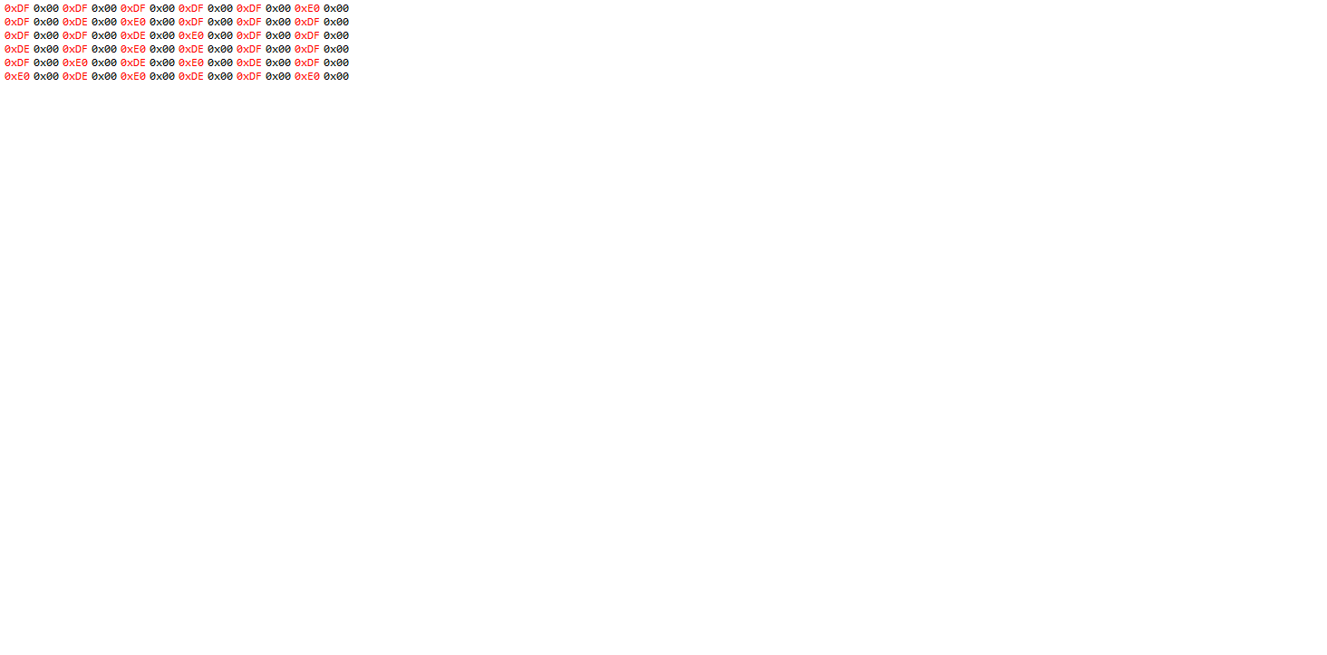

Hi Dennis,
yes, FRAM is set NWAITS_2.
1> I change to delta[count] = RTCCNT - 240
and the delta change to F0 for most of the time .
Attach the result in the following.
This is also the concern that result should be 240 regardless any codes written in between two Timer kicks as long as instructions did not exceed 240 clock cycle. Why is it act like this by just changing one line of code? (actually i did see cases similar to this, this is most simple case to describe)

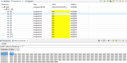

Hi ming,
I setup my project using your original code and it seems to work fine. I get a delta of 223 every time in the ISR.
I have attached my source code for you to try. Note, I had to use FR2355 which is in the same family with same peripherals.
