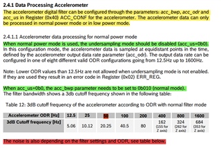

    //Configure the accelerometer
    writeData[0]=0b00101100; //Set acc_us to 0 for off, and acc_bwp must then be 010. Set acc_odr to 1011(800Hz),1100(1600Hz),1000(100Hz),0001(25/32Hz)
    I2C_Master_WriteReg(SLAVE_ADDR, 0x40, writeData, 1);

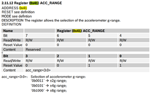

    //Set the range of the accelerometer
    writeData[0]=0b1000; //0b0011 for 2g, 0b0101 for 4g, 0b1000 for 8g
    I2C_Master_WriteReg(SLAVE_ADDR, 0x41, writeData, 1);

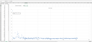

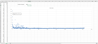

  • Based on your suggestion, I have modified the code a bit and now I am getting very good results. My test platform is vibrating at a frequency of around 3.3~3.5 Hz. And when I am taking 512 samples and 1024 samples, I am getting very good results.
    512 samples: Max FFT 3Hz
    1024 samples: Max FFT at 3 Hz
    But with 4096 samples, I am getting a wrong reading.
    4096 Samples: Maz FFT at 17 Hz
    The BMI160 has an internal counter that increaments the counter at an interval of 39us. So I used it as the timestamp for each data point and the sampling frequency came out to be 933.42Hz.
    Based on the BMI160 datasheet, I realised that I may need to play around with a couple of variables to perform an accurate calculation. One is the bandwidth (page 19), and the second one is the accelerometer range (page 59).
    Bandweidth: As the sampling frequency is 933.42Hz, I should have a bandweidth of 466.71Hz. So, I have chosen the 1600 ODR value (Z-axis).
    Accelerometer Range: Not sure which one to select and why.
