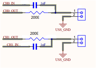

We are working on the accuracy part of Water Meter and bit curious about the calculation behind RC circuit?
Another thing is the imepdance matching of the transducer, do we need to do so?
We have checked the ZFD with 1 MHz transducers and it has too much variation varying between +-100ps with mean value around 10ps.
Now thw question is what do you mean by 25ps accuracy at ZFD? How can we accurately measure the lower flow rate if the ZFD variation is high?
