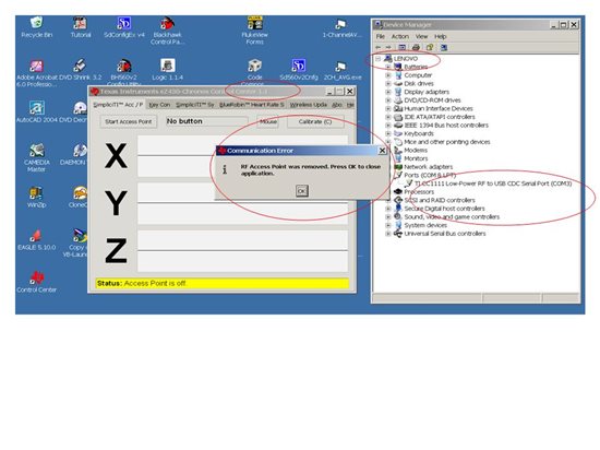

When opening the Control Center software I get the message "RF Access point was removed. Press OK to close application ", and guess what, the application closes.
If I start Control Center 1.2 software with out the RF Access Point installed into the USB port the software loads but when installing the RF Access Point nothing happens.
I have attempted a number of the typical tricks to get TI products to work, and they all have failed.  I could go on and on with the tricks like deleting the driver and directing the driver install to the folder that was installed with the Control Center 1.2 software....I think a few hours of time is enough.

  • A picture is worth 1000 words, all info is in attachment.  This is exclusively an Instrumentation Computer, none of the software you stated is on this machine (PC), just one VCP is active as evidenced below.  The only other VCPs on this machine are from TI products, and I assume they have been tested to play nice with one and another.
    I need to contact TI to get help on this matter and wish a TI rep. would handle this issue. There is a defect in the software or the hardware and specifics regarding this error message below need to be addressed.
  • Issue is 100% reproduced with Chronos 433 kit + Win XP SP3
    Steps:
    1. Attach eZ430-Chronos access point USB
    2. Wait for serial port driver is loaded.
    3. Verify/correct serial port settings.
    4. Run Chronos Control Center.
    Actual result:
    "RF access point was removed. Press OK to close application" appears in a few seconds.
    Observations:
    1. Issue does not depend of the serial port number.
    2. It's possible to communicate with Access point from terminal like PuTTy
  • I too faced the same problem. When i checked the device manager, apart from this module one of the bluetooth serial port was assiagned the same port number. so after i changed the port number of my device, there was no more error.
  • I was having this happen when I tried to connect with my watch. The watch would reset and the program would close. Turns out my battery was too low for wireless connections. A new battery fixed the problem.
