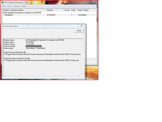

  • Thanks for the reply Jens-Michael, It would definetly seem that for some reason my code size is being limited. I did not think that code size was an issue in the 30 day evaluation. Is there anything that I could be setting up incorrectly in the IAR compiler?
    I double checked that it definetly was the Eval version I had installed and the following screenshot should confirm it
  • Sorry, I have no first-person experience with IAR, and IAR is not a TI product too, so maybe you should ask the manufacturer (and ask for extending the trial period, since you cannot use it for evaluation as it is now :)  )

  • Thanks for the feedback,
    I continued to mess around with various settings until I noticed that the sample project defined it's own custom settings for the Stack/Heap. When I tried unchecking the "Override" checkbox and returning the values to their default settings the project suddenly compiled and downloaded. It now seems to be working fine.
    The code being produced still far exceeds what the kickstart version can handle but at least I can confirm the origional idea that the evaluation version is indeed not limited by code size.
