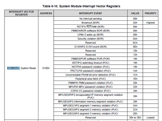

  • HI Eason,
    I read the docs for using the interrupt, I am able to upload the code from another MSP430. When I tried to interface the ESP01 Interrupt is not triggering, when I use debug mode the board got resetting.
    What will be the problem here? Can you help me out, please?
    The module is working fine. I checked.
    Selva
    I assume the problem happens on the IRQ table.
    Can you tell me you appliance for the IRQ table for boot and App.
    Please check whether you successfully move the code to RAM.
    You can also check this register to know what cause a reset.
    Eason
