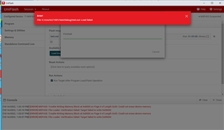

Recently, I was working on MSP430F5510  MCU by using MSP FET flash emulation tool.
At the start of using CCSv6, I can normally debug my device, but several times later, I found it cannot erase memory anymore.
The image file is https://e2e.ti.com/cfs-file/__key/communityserver-discussions-components-files/166/test.out
For solve this issue, I have tried uniFlash to load image, but still failed like below:
[10/14/2022, 1:23:57 PM] [ERROR] MSP430: Trouble Writing Memory Block at 0x8000 on Page 0 of Length 0x30: Could not erase device memory
[10/14/2022, 1:23:57 PM] [ERROR] MSP430: File Loader: Verification failed: Target failed to write 0x08000

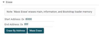

My start and end address limits for erase as follows:

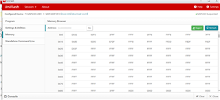

The memory can read out normally.

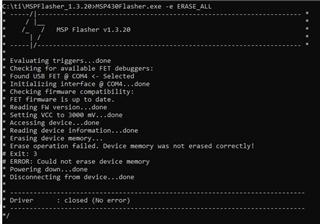

So I wonder if the flash memory has been locked up, I used MSP430Flasher to unlock memory and erase it.
The commends and feedback is like below:
C:\ti\MSPFlasher_1.3.20>MSP430Flasher.exe -u
C:\ti\MSPFlasher_1.3.20>MSP430Flasher.exe -e ERASE_ALL
From the message shows, the memory is unlock status, but still erasing failed.

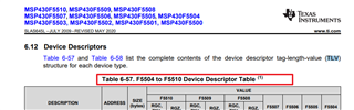

    2. Read the TLV data and check whether it is right.

    For the second, the memory value is showed as follows, it seems different with datasheet.
