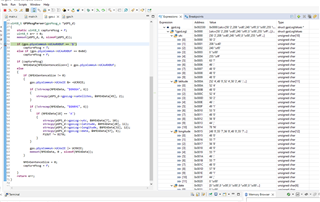

  • Per request....Here are some snapshots....
    the function in a driver library along with the results showing a breakpoint right after memset....As you can see nothing zeroes out....(guessing it has to do with sizeof pointer but I don't know what should go in here to zero out the structure??)...As you can see nothing zeroes out

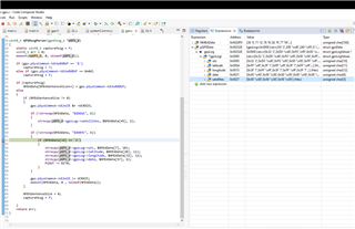

    So ultimately the driver is to fill the structure with values.....Knowing that structure passing is taboo I am passing a pointer from main....Below shows two pics....the NMEA data I am capturing and the arrays (I show date and utc)  after supposed updating (breakpoint set at P1OUT toggle in the driver c file....NMEA looks fine (I show the mssg and the entry prior to A is the utc), struct fields not completely updating, why (latitude field is all correct, longitude is almost complete, missing the E, W entry , date is all zeroes and UTC time doesn't populate the first chars)??
  • A big hint (OK, waving red flag) should be that in your screen dump the data starts at address 0x0000.
  • I agree....very ominous looking....is this a scope thing or a pointer without assignment?
  • Ok....I solved my issue.....I changed gpsLog from a pointer to just a type variable....Can you explain what I would have needed to do to keep gpsLog as a pointer and have it work??(as a HW guy hacking at FW I don't have the answer)

  • Steve,
    I think the problem is that you declared a pointer without creating an actual instance of the struct. A pointer must point to a memory location that has been initialized (or at least reserved) for that data type.
    Evan
  • I suspect you wanted this in your Previous (not your New) code:
    > memset(pGPS_d->gpsLog, 0, sizeof(*pGPS_d->gpsLog));
    This idiom ("memset(ptr, 0, sizeof(*ptr))") isn't always what you want, but it usually is.

  • Hi Evan....
    I thought I did that with this assignment in main: (even though main never pushes data to the function and only receives data from the function)
    gpsMssg_s GPSData = {}, *pGPSData = &GPSData;
  • Right, but gpsMssg_s contains a pointer to gpsLogValues_s *gpsLog. *gpsLog doesn't have an associated structure in memory yet.
    Evan
