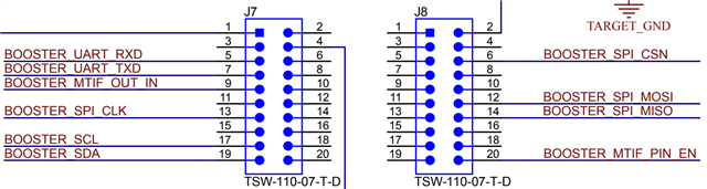

From what we've seen on the TIDM-02003 schematic, it seems the only eUSCI_A module available is eUSCI_A2, which is multiplexed to pins 0,1,2 & 3 of Port J. These are connected to the BoosterPack pin headers (J7 & J8) as shown on the schematic:
We've also set J30 in order to use pin 1 of J7 as VCC for the level shifter.

Checking the EVM schematic once again we found that pin 17 on the MSP430, which is multiplexed to PORTJ.0 and is connected to the BOOSTER_SPI_CLK pin on J7, is labeled as UAC2CLK instead of UCA2CLK:
At first we thought this was simply a typo, as we didn't find any other pin with a similar name and it seems from the datasheet that this pin is indeed connected to the CLK of the eUSCI_A2 module.
We'd like to know if it is possible to verifiy if clock is being read by the eUSCI module, or what could be the issue here that is causing this behavior.

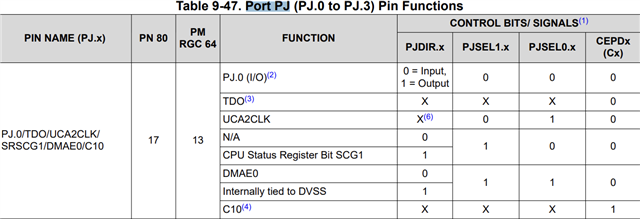

  • UPDATE: I tried reducing the CLK frequency for the SPI protocol and I was able to see some output on the MISO pin of the eUSCI_A2, however, that didn't solve the issue completely.
    It turns out i wasn't setting the Port PJ pin functions correctly. As it can be seen on the attached code, i used the `GPIO_setAsPeripheralModuleFunctionOutputPin()` (or input, depending on the case) function from the driver library to set pins 0,1,2 & 3 of port PJ (which correspond to CLK, STE, MOSI & MISO respectively) to `GPIO_SECONDARY_MODULE_FUNCTION`, which I thought corresponded to the eUSCI_A2 module since on the datasheet the eUSCI_A2 is selected by setting PJSEL1.x to 0 and PJSEL0.x to 1:
    Intuitively, I thought that GPIO_SECONDARY_MODULE_FUNCTION corresponded to PJSEL1.X=0, PJSEL0.X=1, while GPIO_PRIMARY_MODULE_FUNCTION corresponded to PJSEL1.X=0, PJSEL0.X=0. However, upon inspecting the code, I found out that GPIO_SECONDARY_MODULE_FUNCTION actually corresponds to  PJSEL1.X=0, PJSEL0.X=1. In order to use Port PJ as GPIO, one must call the GPIO_setAsOutputPin() function. Upon changing the module function I was able to send and receive from the MSP to the Arduino.
    So, for anyone else who is having a similar issue, make sure you're setting your ports correctly, GPIO_setAsOutputPin() sets PJSEL1.X=0, PJSEL0.X=0, calling GPIO_setAsPeripheralModuleFunctionOutputPin() with GPIO_PRIMARY_MODULE_FUNCTION sets PJSEL1.X=0, PJSEL0.X=1 and so on.
    Thanks to @David Schultz and @Johnson He, I couldn't have figured this out without your help.
    Best Regards.
  • Table 12-2 in the family guide lists the correspondence between SEL bits and module function. No intuition required.
