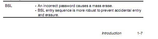

Do all msp430 series have the BSL func? include G2 series? Will the mcu erase all flash,when users send incorrect password? in other words, the flash of mcu is empty.

Hi token,
only some of the value line devices have the BSL (i.e. MSP430G2x53 / MSP430G2x13). If the BSL password is incorrect the BSL will erase the hole device. Detailed information on the BSL are available in this application note: http://focus.ti.com/mcu/docs/litabsmultiplefilelist.tsp?sectionId=96&tabId=1502&literatureNumber=slau319a&docCategoryId=6&familyId=342

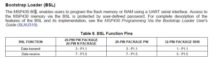

Well, that's because MSP430G2452 DOES'NT has a BSL!!
The image above is from page 12 of the MSP430G2553 data sheet (http://focus.ti.com/lit/ds/symlink/msp430g2553.pdf)! This device (and all other devices of MSP430G2x53 and MSP430G2x13 sub series) HAVE BSL.
Rgds
aBUGSworstnightmare

You explicitely asked for the G2 family.token Jiang said:I think your replies are not right.
Basically ALL MSPs of the F series do have a BSL of some kind (usually timer-based software UART, but those with internal USB controller have an USB BSL), but most of the G series do NOT have a BSL, nor does the L series (which has no flash).
For the G series (and maybe the FR series), check the datasheet of the processor in question, and when it lists BSL feature, then it has one.
