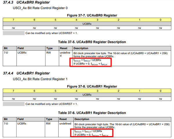

2. When I setting spi_master_Params.bitRate = 1000000, I can measure SPI CLK about 1MHz.
But when I setting to 3000000, it will become 4MHz. Does the limit is 1MHz on TI-RTOS system?

    2. I suggest you check bit 6-7 of UCB0CTL1 Register for the source clock, and then you can calculate the clock frequency as shown in following picture:

    2. My clock setting:  MCLK = 8192000  , ACLK = 32768  , SMCLK = 8192000.
       and SMCLK used as SPI clock. (.clockSource = USCI_B_SPI_CLOCKSOURCE_SMCLK)

    2.As the spi clock is about 8MHz, it cannot be evenly divisible by 3MHz, so it will not be your expectation. Please check how "spi_master_Params.bitRate" is used, I think it will do a division like "(int) 8MHz/3MHz=2", then set  UCBRx =2, so the real frequency is about 4MHz.

    Thanks for your teaching. Now, I understand why spi_master_Params.bitRate set 3000000 will become 4MHz ,not 3MHz.

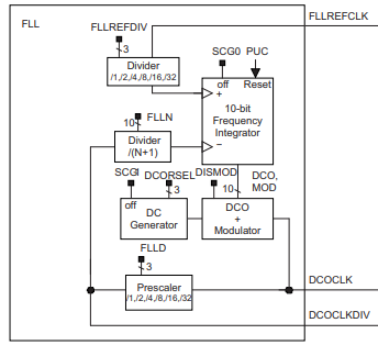

    Does the SMCLK can change to 24MHz on TI-RTOS system? It will affect tasks on system?
    Thanks.
  • Hi there,
    Surely yes, the max frequency of MCLK / SMCLK is 25MHz.
    I am not familiar with RTOS system, and in my opinion it mainly includes the execution method of multiply tasks. So improved CPU clock will improve system performance, and then time cost of tasks will decreased. You should check each task time cost and do evaluation if necessary.
    You can refer to the section 5.2.6 of use's guide for clock setting.
    Here is the general instructions:
    For example, set FLLN=22, and FFD=32, then the DCOCLKDIV is about 24MHz.
