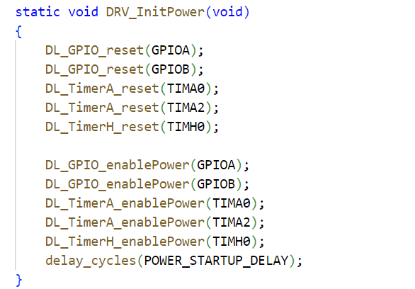

I am developing with LP-MSPM0G3507, and one of the capture interrupts has been unable to enter. After adjusting it for a long time, it's not correct.
I will post the interrupt configuration and the pin code that signals it below.
Initial power:

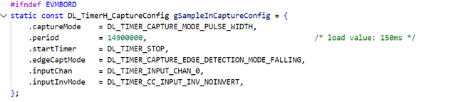

Capture config: 14900000=(150-1) * 100k, it should be calculated correctly
initialization:
pin:
The signal given to him is given in the systick interrupt. The systick interrupt is 1cnt=5ms, and the pin pulls PB13

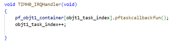

  • Hi Shi,
    Where do you enable the NVIC TimerH interrupt in your code?  Enabling only the Timer's interrupt is not enough.  You have to also enable this interrupt with the NVIC.
    Example:     NVIC_EnableIRQ(TIMER_INST_INT_IRQN);

    Now the interrupt is available! But here comes another problem.
    I want to count the time value so I used DL_TimerH_getCaptureCompareValue().
    But the value is wrong and it seems to be not controlled.
    What factors do I need to pay attention to.
    Thanks!

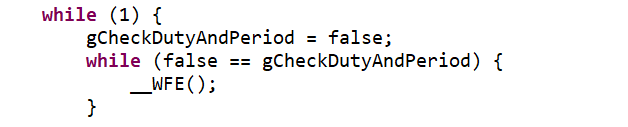

    So I decided to use CCStudio 12.1.0 to have another try. (I have previously encountered monitoring variable exceptions and resolved this issue by changing the optimization level. In addition the CCS Theia can't select the optimization level)
    Here comes to the catastrophe!
    The program was stuck in the following "while". Then I cut off the power.
    It's not the problem. The problem is I can not connect to my board anymore!
    Force reset is useless. BSL failed. Factory reset failed.......
    I have already broken three boards....... (Although I am a fresh graduate, one month broke three boards was a great feat...ToT)
    Now I have no launchpad anymore. But it doesn't mean I give up.
    I will read the "MSPM0G_TRM_v0p6" 's TIMH. And if there's any process, I will let you know as soon as possible.
    Best Regards!
  • Hi Shi,
    By chance, do you put the CPU in sleep or stand-by mode?  If you did this, the next time the debugger tries to connect to the device, the MSP has already come out of reset and entered one of these two sleep modes before the debugger gains control.  This is well published bug in the version of silicon on the launchpads.
    Since the factory reset fails, try the following:
    Change the code that puts the MSP into sleep mode to use only the SLEEP mode.  Build you project, and start the debug or download process.  Hold down the BSL button (S1) and just before CCS starts to download the code, release the BSL button.  What this does is force the MSP into BSL mode which means your code is not yet running, and you have about 10 seconds  for the debugger to connect.  It may take you a couple of tries, but once it programs you are good.

    The TI engineer in shanghai contacted me and told me that the first batch of MSPM0 has a bug.(It seems that some delay settings are particularly high, causing the chip to enter a low power consumption mode without being controlled.)The "_WFI" and "_WFE" may cause the problem.
    My broken launchpads have been delivered to him. And he would sent his launchpad to me.
    I will continue to learn about the capture interrupts.
    Wait for my good news.
  • Hi Shi,
    I see. Yes, the WFI (wait for interrupt) and WFE (wait for event) is the instruction to put the CPU in one of the 4 sleep modes.  If you don't specify which mode  the CPU will enter SLEEP0 mode and will work with the debugger no problem.  Using either the STOPx or STANDBYx modes are what cause this issue, but only a problem on the pre-release silicon that came populated on the launchpads.  The silicon version that was released last week has that bug fixed.
    So out of curiosity, do you use an instruction like this one? DL_SYSCTL_setPowerPolicySTOP0();  If so, you run the risk of causing the same issue on new launchpad.  Please let me know.
