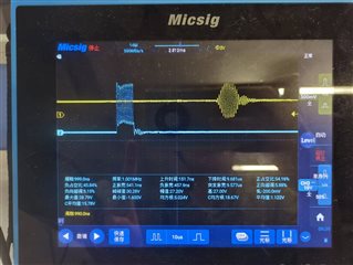

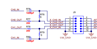

Hi Team,
Here're some questions from the customer may need your help:
Our company plan to design a water meter using msp430fr6043. We have modified the capacitances and resistances on the EVM430-FR6043 in Figure 1. We used the code examples for msp430fr6043 which named msp430fr6043_saph_01.c, and the code is then posted. We used an oscilloscope to view the waveform of the CH0_OUT pin, as shown in Figure 2,3. The problem we faced was that the oscilloscope waveform was not a square wave, and we suspected that it was not an excitation signal. We want to generate an incentive signal first, but we do not know what is wrong with this, please inform us, thank you very much!
Figure 1
Figure 2
Figure 3

  • Hi Yale,
    How do you get the oscilloscope figure? Have you attached the transducer on the CHx_OUT pin and then measure the signal?
    Cash Hao
  • Hi Cash,
    Thank you very much. I found that the parameters of the oscilloscope were wrong, and the waveform in the figure was actually noise. After adjusting the parameters, the oscilloscope could display square waves. But when capturing the waveform, the data was placed in the result array, and I copied the values out. There were only 256. The waveform drawn in excel did not show the receiving pulse. How can I solve this problem?
    Thanks & Regards
    Yale

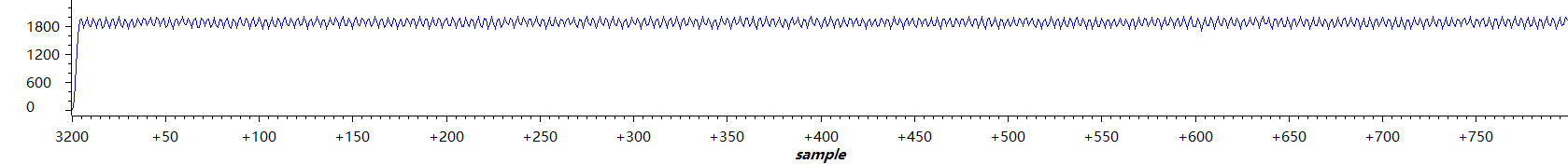

  • Hi Cash,
    The reply from the customer:
    Yes, the graph is drawn using a template example. The code is as follows. I'm confused about the waveform of the values in the result array. Because I can see waveform on oscilloscope when I captured X_CH0_OUT and X_CH1_IN, as shown in Figure 1 & 2, but not in ccs, as shown in Figure 3. I don't know which step I made a mistake, what should I do?
    Figure 1
    Figure 2
    Figure 3
