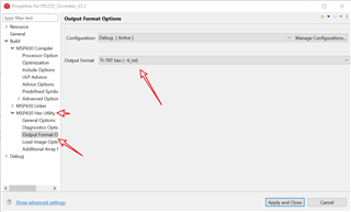

  • Hi Senthilprabh,
    You can generate .txt file in CCS:
    Then load this image into MSP-GANG, click Go button is OK.
    I think use XDS110 for TM4C mass production.
    Thanks!
    Best Regards
    Johnson
