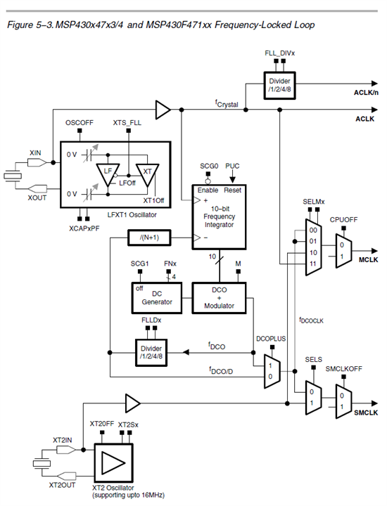

In my tests, I saw that higher frequencies have less jitter for example 16Mhz, but how that can be possible? What are the relations between FN_x, D, SCFQCTL parameters and jitter?
  • When FLL is enabled and achieved the DCOCLK usually switches automatically between two different frequencies. The goal of the FLL is so that the average frequency over any consecutive 32 cycles of DCOCLK is as close to the desired multiple of the reference as possible. In doing so, it “jitters” between two steps of adjacent MODx settings in a predictable way. According to the data-sheet (slas626C.pdf) page 40, the step size, Sn, between adjacent DCO taps can be anywhere from 6% to 17%.
    If you do not want DCOCLK to “jitter”, you may disable the FLL and set the MODx bits to all 0’s. But you will have very limited choices of the DCOCLK frequencies and they depend on operating temperature and voltage.

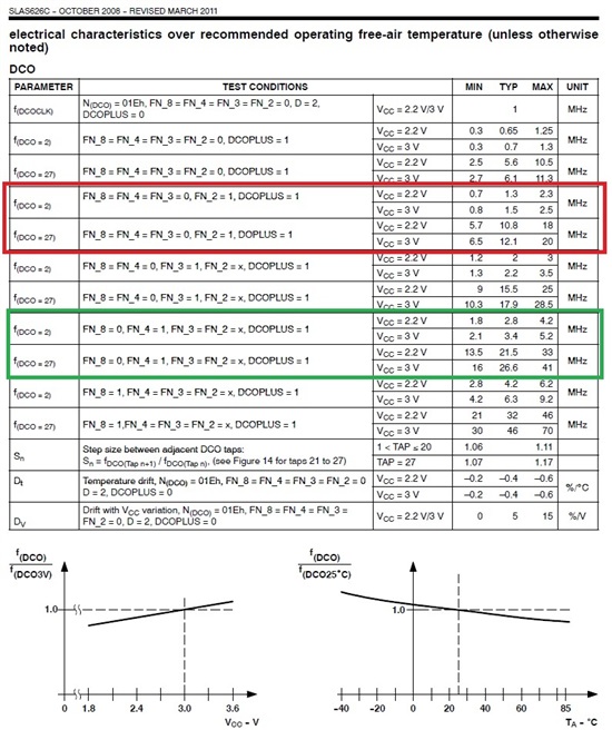

    Dear old_cow_yellow,
    I did not know how to choose FN before. SCIF0 register explanation in the user manual seems not enough. (Or I can say it is not correct)
    In the datasheet, given FN table is different. In our design VDD is around 3.45V and I need 8 MHz. If I choose FN_2, there is possibility to get failure. Because, even with the max tab, it might not reach to 8 MHz. So for the jitter also, it is good to maximize FN as much as possible. Because lower tabs (between 1-20) have more precision.
    Tomorrow, I will check current tabs, and try to reduce them by choosing higher FNs.
    Thanks.
    Today I did a test by disabling FLL loop. ( _BIS_SR(SCG0); )
    With FN_4 and DCOtab=11 and MOD = 0, I measured MCLK is 7.89 Mhz
    With FN_4 and DCOtab=12 and MOD = 0, I measured MCLK is 8.56 Mhz
    Well, my target is 8.00 Mhz. From datasheet explanation, I used that equation to solve MOD to get my target frequency:
    [ f_dco _tab*(32-MOD) + f_dco _tab1*(MOD) ] / 32 = Target Frequency
    For my case f_dco _tab = 7.89
    f_dco _tab1 = 8.56 (this is DCO tab+1)
    and Target is 8.00Mhz.
    When I solved the equation I found MOD should be 5.25, so the closest integer 5 I chose. With 5 expected frequency is 7.994 Mhz which is fine.
    The test result was fine, I measured frequency around 8 Mhz and jitter is only about 7%.
    But my question, why does MSP FLL loop have more jitter than 7%? It seems during operation, MSP changes the DCO tabs more than one step. This shouldn't be required. Why do you think?
    Thanks.
    accordign to the datasheet, the factor between DCOx and DOCx+1 is 1.06 to 1.11, so the maximum jitter will be 11%.
    Besides this, OCY i sright: overclockign the DCO and use a divider averages 2 or 4 DCO cycles, so the average jitter will be by a factor 2 to 4 smaller. (and since modulation has an evenly distribution of the two frequencies, the maximum jitter won't be noticeably higher than the average jitter)

    I've just understood the functionality of FLL Divider.
    My application is battery powered and VDD of MSP can vary between 2.3V and 3.5V
    For these conditions, I couldn’t find proper FN option to get 8 MHz without DCO failure.
    If DCOPLUS=1, here are the conditions I have to fit:
    @2.3V Min DCO_tab27 frequency should be greater than MCLK asked * D for the chosen FN
    @3.5V Max DCO_tab2 frequency should be less than MCLK asked * D for the chosen FN
    Let’s suppose we chose D=4 with DCOPLUS=0 to decrease jitter by averaging. In that case, we need fDCO = 32 Mhz. Even with FN_8 option, @2.2V Min DCO_tab27 = 21 MHz so highly possible to get DCO failure.
    How are you choosing FN value?
    Or are you using some smart code inside oscillator failure interrupt?
    Thanks.

    But then, I'm not using a 4x device, and the 5x devices have a superior clock unit. Here the DCO can be stepped in 8 ranges with >100MHz output, and MCLK/SMCLK dividers can be chose independently of the FLL divider. It is easier to find a fitting configuration here. And the 1611 I'm using in my older projects doe snot have an FLL nor does its DCO go above ~6Mhz, so I need a crystal anyway to go for 8MHz. And I need 3.6V Vcc or it won't work on 8MHz at all. If your choices are limited, you often have less problems :)
    However, using a divider of 2, going for 16MHz DCO clock, will work in FN_8 for full operating voltage range.

    With the options FN_8, D = 2 and DCOPLUS = 0, we need 16Mhz at DCO output to get 8Mhz in MCLK. This configuration seems OK for FN, it covers all the VDD range required. But that time problem is N. We need a value decimal 244 for N which is not possible. N has only 7 bits.
    And with D=4 you have the same problem, don't you?With DCOPLUS=0, you only shift the DCO range, but the DCO clock output to MCLK and SMCLK is always N*fref. Which is 4.2MHz at max with a 32768Hz reference crystal.
    So all you can do is going for DCOPLUS=1 and D=2 and N=122. Then FN_4 or FN_3 are fine. You don't have any jitter smoothing then, of course.
    Looks like this MSP is not the optimum device for low-jitter 8MHz DCO operation :)
