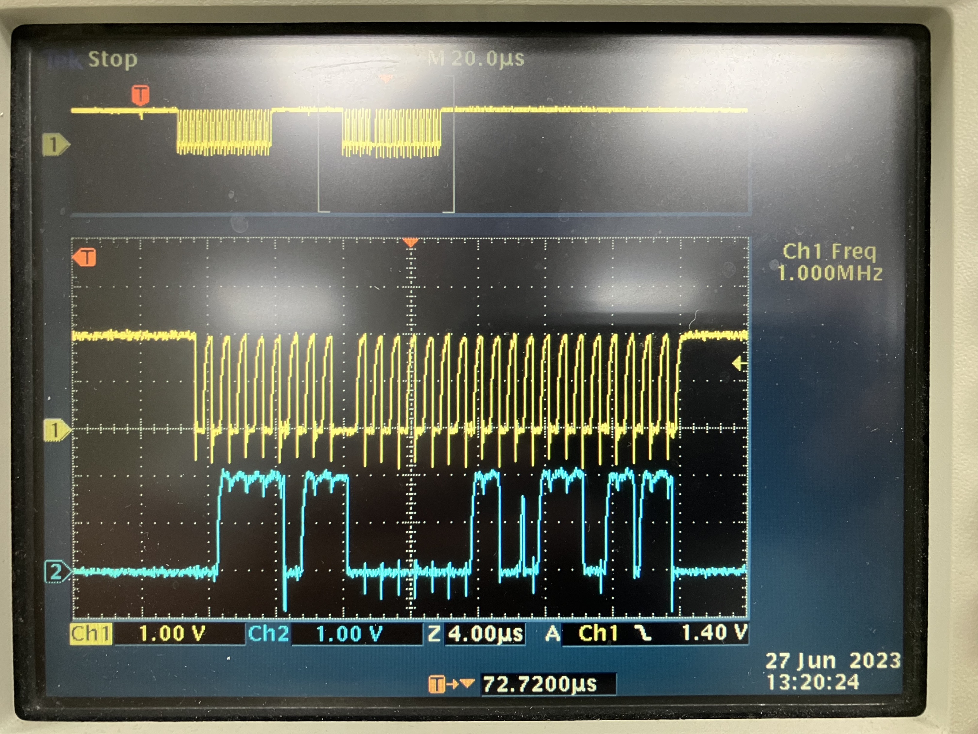

I have an application that I2C speed 1MHz with a slave device.
The normal I2C read waveform with another host as below:
You can see a little stretch after 8th SCK for waiting slave ACK.

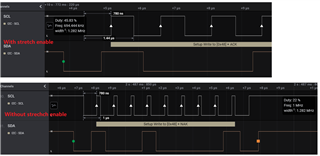

And LP-MSPM0G3507 I2C read waveform as below:
It don't have stretch and I get NACK interrupt.
I have enabled controller clock stretching and I2C configuration as below:
Am I missing other settings?
BTW, It works when I slow down to 400KHz. (the waveform no stretch)
