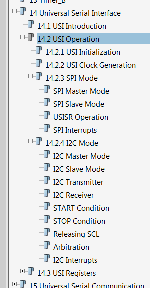

  • Yes, the USI is suitable for master and slave operation in I2C and SPI modes.  Here is an outline view of the relevant chapter in the x2xx User's Guide:
    In MSP430, there is a User's Guide for an entire family (G2xxx and F2xxx all use the x2xx User's Guide).  There is also a data sheet specific to your selected processor.  Often the data sheet applies to only a few of the many many models in the family.
