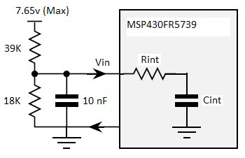

  • Hey Jens,
    For the life of me i could not fine the value for Ci in the http://www.ti.com/lit/ds/symlink/msp430fr5739.pdf document, so i picked the value of 5pF from the http://www.ti.com/lit/ds/symlink/msp430g2452.pdf datasheet.
    So my circuit looks like the following
    so
    Rin = [(39K * 18K)/(39K + 18K)] + Rint
    Rin = 12.3K + Rint = 12.3K + 1K = 13.3K ohms
    So Tau ~=13.3K * 5pF =66ns
    7.6*Tau = 505ns
    Im using MODOSC for the ADC10CLK so thats around 5MHz sooooooo,
    505ns * 5MHZ = 2.5 cycles round up to 4 so a ADC10SHT_0 is good enough?
  • The FR datasheed is very incomplete (under development).
    However, 5pF is not much. Are you sure? I've seen 25pF as well (MSP430F5438).
    However, with your 10nF as buffer, the R is with 1k relatively low, so the TAU is very small.
    Also, if the input value is only slowly changing, the Cint is precharged after a few cycles, so the required gate time decreases.
