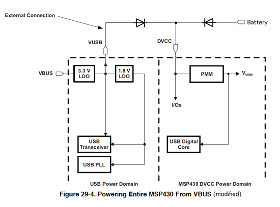

I am using MSP430F5528 for a battery operated device. I use the TI BSL (through USB port) to write the new firmware. Once the BSL firmware upgrade completes, then it executes my firmware. On startup, I do not turn on any devices and set every pins on the MSP to a valid state to save power. I unplug the USB cable after BSL.
My target is 350uA. But I am ending up with 750uA.
BUT when I unplug the battery and plug in back in I get 350uA. That means, the USB module is running even after the BSL is  completed. I tried disabling the USB by calling USB_init(), USB_disable(), USB_disconnect(). No luck. I also initialize each & every USB registers on the MSP to 0 to make sure everything is in a PUR state.

  • Sound like your board supplies 3V3 rail to the Vusb pin from the on-board power source (battery?).
    If so, cut off Vusb pin from the on-board power. Connect just a 220nF capacitor to Vusb pin.
    The code of TI's USB package supposes that the USB power domain of the chip is separately supplied from USB connector over the VBUS pin. As the default after power-up, the on-chip USB 3V3 regulator is enabled (USBPWRCTL.VUSBEN). On the source code, the USB 3V3 regulator is kept enabled, as follows.
    MSP430_USB_Developers_Package_3_0_0_0\MSP430_USB_API_Stacks\examples\...\USB_API\USB_Common\usb.c
    BYTE USB_init(VOID)
        USBPWRCTL   =     VUSBEN + SLDOAON; // enable primary and secondary LDO (3.3 and 1.8 V)
    On the USB BSL code, the USB 3V3 regulator is enabled, too.
    SLAA450.zip - \Custom_BSL_Zip_File\BSL_Source\Peripheral_Interfaces\USB\usb.c
    VOID USB_init(VOID)
        USBPWRCTL  = VUSBEN + SLDOEN + SLDOAON + VBOFFIE + VBONIE; // enable interrupt VBUSoff, VBUSon, keep primary and secondary LDO (3.3 and 1.8 V) enabled
    In this way, the USB power domain doesn't draw any current from the battery.
    To enable BSL without on-chip battery, you may add diodes across Vusb/DVCC pins.
    Tsuneo

    Tsuneo, There is actually a capacitor on the VBUS already on our board. But by sending the latest BSL code snippet, you helped me identifying the problem.
    Jeff, you are correct, it’s not the USB but the timer B. In the PI_init() function of the BSL, it is turning on the timer B (TBCTL) and not turning off. I missed that one.
    (SLAA450\Custom_BSL_Zip_File\BSL_Source\Peripheral_Interfaces\USB\BSL430_USB_PI.c)
    Now my code works great the battery consumption ~360uV as I wanted.
