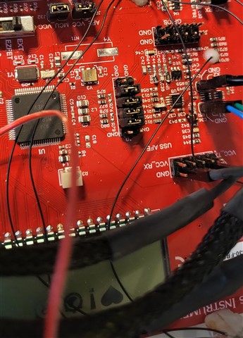

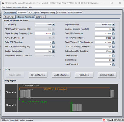

I have an issue with my EVM430-FR6043 as shown in the screenshot below. Can someone help me to resolve it please?

Hi Billal,
Can you send an image of your board when plugged in and powered on? I want to see the jumper configuration.
Also, how does the board appear in device manager when you connect it to your PC?

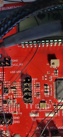

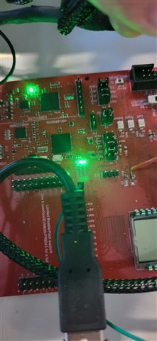

Hello Brandon,
Thank you for considering my request, here are images of my board plugged in and powered on. Note that the LED202 is blinking.

Hi Billal,
It looks to me like the board may have the production test firmware still loaded. Can you try flashing the latest version of the USS firmware as described in our Gas Meter Quick Start Guide (SLAU824)? Section 3 is the relevant portion.

Hi Brandon,
I have already done everything just mentioned and as indicated on the document (Gas Meter Quick Start Guide) and I still get the message "waiting for device". Is there an other solution?Billal,

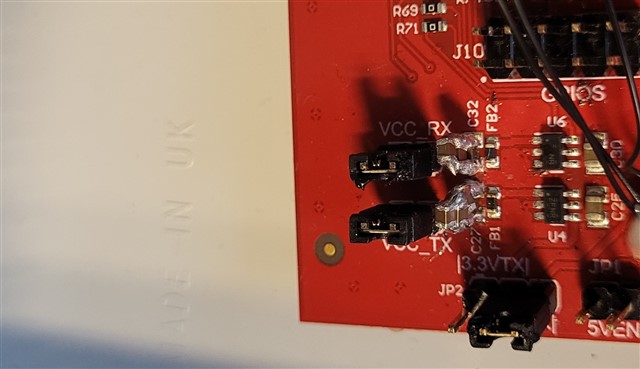

Do you get any errors or messages when you attempt to update the firmware via Uniflash?
Have you used this board successfully before? It looks like you've done some modification to the passives on this board.
Brandon Fisher
No, I don't get any errors or messages when attempting to update the firmware via Uniflash. However, personally, I've never been able to successfully use this board before and I I haven't made any modifications to the board.

Hi Billal,
You got this board from someone else then? Did they have it running to your knowledge? I ask because it does look like its been modified quite a bit by hand.
