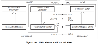

Dear TI Experts,
  I have a problem with configuring four-pin mode here for MSP430G2553 launchpad. I was able to transmit and receive data through UCA0 3-pin SPI channel, but I now need to use 4-pin SPI channel which includes UCA0STE. And when initializing the configuration with UCMODE1=1 ,UCMODE0 =0 (UCA0STE active low), transmission cannot be done and  I found UCFE (Frame Error Flag) was set right after initialization. I understand UCFE indicates a bus conflict, but it was set as bit 1 even I did not connect the bus at all. My code was as follow: (Plus, when UCMODE1=0 ,UCMODE0 =1, UCFE remained normal as bit 0. )
  void InitSpiBusA0(void)
    //Pin function select
    P1SEL |= BIT1 | BIT2 |BIT4;
    P1SEL2 |= BIT1 | BIT2 |BIT4;
    UCA0CTL1 |= UCSWRST | UCSSEL_2;
    /*UC Reset , SMCLK*/
    UCA0CTL0 = UCCKPL|UCMSB|UCMST|UCMODE1|UCSYNC;
    /*SPI MODE, MSB first, Master mode, UCxSTE enabled and active low*/
     /*SPI bit rate*/
    UCA0BR0 = 1;
    UCA0BR1 = 0;
    /*SPI disable reset*/
    UCA0CTL1 &= ~UCSWRST;
void SpiBusMasterWrite(uint8_t data)
    /*Feed Data into Buffer*/
    UCA0TXBUF = data;
    while(!(IFG2 & UCA0TXIFG));
int main(void)
    WDTCTL = WDTPW | WDTHOLD;
    InitSystemClock();  //1MHz
    InitSpiBusA0(); // after which UCFE came out
    SpiBusMasterWrite(0xAA);
    master_receive_data = SpiBusMasterRead();
    while(1)
        __delay_cycles(1000000);
    return 0;
Hope someone can kindly point out. Is there anything else I need to take care of?  Thanks.
